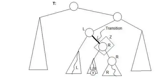

Also, in this picture from the notes of a Demaine's course the transition point Z is drawn above the node y (i.e. closer to the root than y):
Transition point from the notes

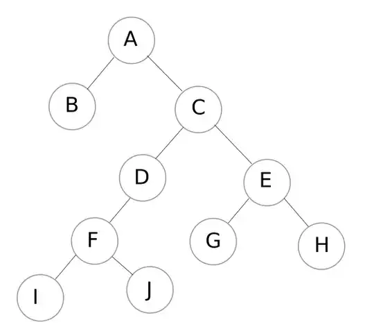

For example, given the following tree
A BST
For the nodes B, D, G, H, I there is no definition of the transition point (because there is no right region in the first place), assuming I understood the linked answer correctly.

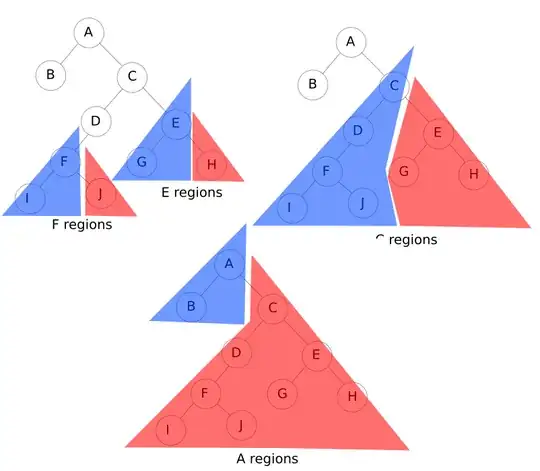

The left and right regions of the remaining nodes (F, E, C and A) should be these ones
Regions of the nodes F, E, C and A
With the left region in blue and the right region in red.

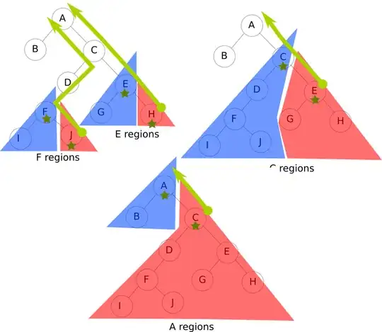

Now, since the path from transition point to the root must include a node from both regions (of a given node y) and since these regions' nodes are, by construction, at least as deep in the tree as y (i.e. at the same distance from the root as y or farther away), the transition point cannot be above y (when drawn in a picture of the tree).
Finally, for a path (to the root) to cross both regions it must originate in the right region and pass through y.
That's the only way I can imagine such a path. Then, since the transition point must be of minimal depth, the root of the right region seems to be the only candidate.
In the picture below the light-green arrows depict the path from the Transition point to the root. The transition point is the node close to the rounded end of the array. The dark-green stars mark the node in the left and right regions (of a given node) the path goes through.
The TPs and their paths
So, in this example, the transition points should be C, E, H, J.
