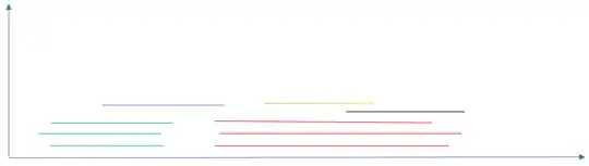

Below is a (very simple) example of the problem marked as I would do manually. The three green intervals and the three red intervals should be reported as groups, whereas the other three are a group on their own. The overlap of the blue interval is too small. The Yellow interval is not "similar" to the red ones in size.

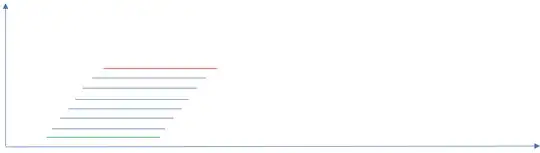

There may be problems like in the diagram below which I am not sure how to address. The green (bottom) interval and the one above it are certainly "the same" as are the red one and the one below, however the green and red are already too far apart to be considered a group.

Here is one interpretation of your problem:
Given $n$ observed intervals $I_1,\dots,I_n$ and $k$, find $k$ disjoint inferred intervals $J_1,\dots,J_k$ that maximizes the number of observed intervals are covered by at least one of the inferred intervals. Say that $I_i$ is covered by $J_j$ if they have at least 95% overlap, where the overlap between $I_i,J_j$ is measured as $|I_i \cap J_j|/|J_j|$ where $|\cdot|$ denotes the length of an interval.
This problem can be solved with dynamic programming. Sort the endpoints of the observed intervals. For each endpoint $e$ and each $k_0$ with $0 \le k_0 \le k$, let $f(e,k_0)$ denote the maximum number of observed intervals that can be covered by $k_0$ disjoint inferred intervals that are all in $[-\infty,e]$. Then you can write a recurrence relation for $f$: in particular,
$$f(e',k_0) = \max(f(e^*,k_0), \max \{f(e,k_0-1) + \eta : e<e'\})$$
where $e^*$ is the endpoint immediately before $e$, and $\eta$ is the number of observed intervals that are covered by $[e+1,e']$.
That said, I suspect a more pragmatic approach might be to use some standard clustering algorithm, adapted for this problem. For instance, you might use k-means on the centers of the intervals. Given a set of intervals that have been clustered together, you might use the median of their left endpoints and median of their right endpoints to define a new interval that serves as the clusterhead. You can probably come up with other heuristics. It's plausible that this might be adequate in practice.
