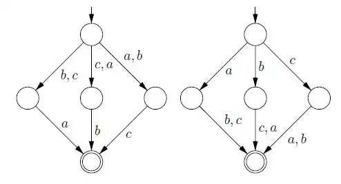

Here is an example for the finite language $\{ ab, ac, bc, ba, ca, cb\}$. The two automata are both state-minimal. The example is from the paper A note about minimal non-deterministic automata by Arnold, Dicky and Nivat.
two NFA for the same language
This answer tries to express the fact that the two problems are "technically" different. See the answer by vzn for details how the problems differ in computational complexity.
