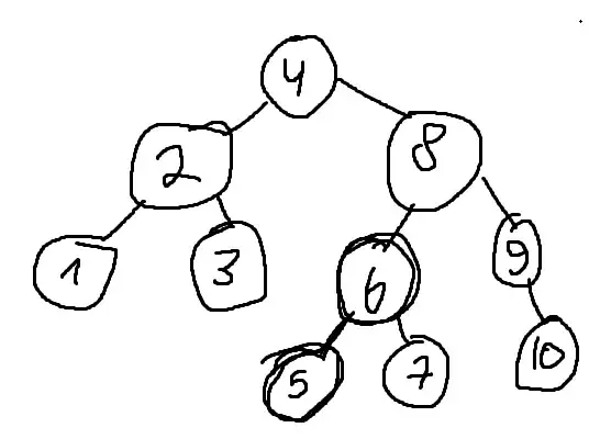

Let's say I have this tree (as Steven suggested to build an AVL of unoccupied rooms) so in this matter it is $\text{Init(10)}$ And Now I want to do $\text{GetMinUnOcc(5,7)}$ so it should delete $5$ from the tree as it will become occupied. But in what you suggest, we find the successor of $l=5$ which is his parent, $6$ and delete it, but, $5$ is not occupied and we want to return the minimum so we need to actually delete $5$, where am I wrong? Thank you!

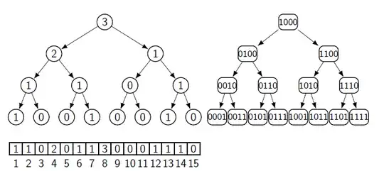

This can be done using a simple array.
Note that the complexity depends on the total number of rooms, and not on the number of (un)occupied rooms. So we might as well store all rooms. The trick to do the counting of free rooms is basically the same as in the case of AVL trees in the other answer. On top of the linear list of arraus we build a complete binary tree, such that each node stores the number of free rooms in the interval of rooms below.
We can find the number of free rooms in an interval by looking for the rooms $\ell$ and $r$ in the tree, and start counting from the node where the two paths diverge. Then for $\ell$ we count the free rooms to the right, for $r$ the free rooms to the left.
The next free room from position $\ell$ is found as follows. First go up in the tree untill we find a node where we came from left, and the right subtree has an unuccupied room. Then go down to the first free spot.
Going up and down, left and right is done using bit-matic. I strore the rooms in the odd indices. The ndes above are even. The number of trailing zeroes in the binary index indicates the level of the node. Left nodes end with "01" and then zeroes, right nodes have "11" and zeroes.
Picture below depicts eight rooms, stored at positions 1,3,5,...,13,15. Numbers in the tree indicate free rooms. So in this situation leaves 3,5,9,11,15 are occupied, indicating rooms 2,3,5,6 and 8.
Storing the complete tree as an array is also done for binary heaps. However, the representation is different. For the heap the root is the first node in the array. Kind of upside down from this one.
