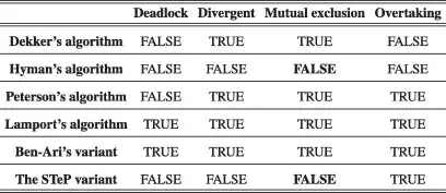

In the following paper we give formal models for Peterson’s and Dekker’s algorithms (and some others) and we used model checker to prove their properties. Please, find our results in the table below (columns "Deadlock" and "Divergent" refer to our models, "ME" = TRUE means that the algorithm is correct, "Overtaking" = TRUE means that it is fair).
R. Meolic, T. Kapus, Z. Brezočnik. ACTLW - An Action-based Computation Tree Logic With Unless Operator. Information Sciences, 178(6), pp. 1542-1557, 2008.
https://doi.org/10.1016/j.ins.2007.10.023
