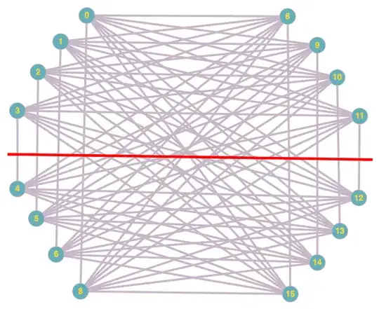

Here is an illustration.
The graph is a slight modification on your example of $ K_{2n,2n}$. It is the complete bipartite graph of vertices sets $\{0,1,2,\cdots, 2n-1\}$ and $\{2n, 2n+1,\cdots, 4n-1\}$, plus edges $\{0,2n-1\}, \{1, 2n-2\}, \cdots, \{n-1, n\}$, $\{2n, 4n-1\}, \{2n+1, 4n-2\}, \cdots, \{3n-1,4n\}$. The initial cut is shown by that red line in the middle. We can check that cut cannot be improved by moving 1 or 2 vertices from one side of the partition to the other, nor by switching 2 vertices on opposite sides of the cut.
The maximum cut is along the original complete bipartite graph, which has $2n\cdot 2n=4n^2$ edges. The cut above has $2n^2+2n$. The approximation ratio is $$\frac{2n^2+2n}{4n^2}=\frac12+\frac{1}{2n}.$$
