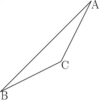

An easy contradicting example is three points forming an obtuse triangle. Note that any Axis-parallel square containing $A$ and $B$ on its boundaries, contains $C$ in its interior and hence, the outer face is not bounded by a cycle since $AB$ is not an edge in the graph.
Obtuse triangle
