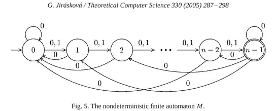

Just to complement what Hendrik Jan's answer already states: there is an earlier work by Galina Jirásková, where an explicit NFA construction has been shown (attached below) that has $n$ states in it and whose comlement NFA requires at least $2^n$ states. The complement NFA is described based on the fooling-set argument, which essentially tells what sequence goes into a state and what comes out of that.
original NFA
codeR
