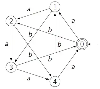

In my class a student asked whether all finite automata could be drawn without crossing edges (it seems all my examples did). Of course the answer is negative, the obvious automaton for the language $\{\; x\in\{a,b\}^* \mid \#_a(x)+2\#_b(x) \equiv 0 \mod 5 \;\}$ has the structure of $K_5$, the complete graph on five nodes. Yuval has shown a similar structure for a related language.
dfa for #a+2#b = 0, mod 5
My question is the following: how do we show that every finite state automaton for this language is non-planar? With Myhill-Nerode like characterizations it probably can be established that the structure of the language is present in the diagram, but how do we make this precise?

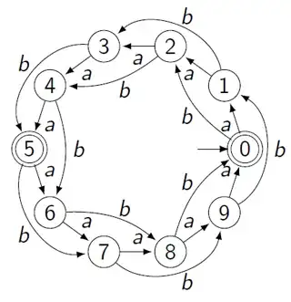

It isn't true that every DFA for this language is non-planar:
Counterexamplediagram of the example
