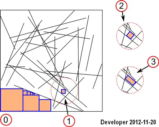

Consider a region (2D) filled with lines randomly (following Figure). We are interested in filling the empty spaces between lines including four boundary edges in a way:
0- maximizing the size of parcels;
1- shape of filling parcels is square aligned horizontally or vertically;
2- shape of filling parcels is square, i.e., relaxed alignment;
3- shape of filling parcels is any quadrangle. our original question
So for now there are three different scenarios.
Note that the lines are of the form [x1,y1,x2,y2] point set, real numbers.
[* * *] Ideas of possible solutions/algorithms/code snippets/etc are more than welcome.

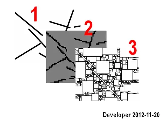

For the first case i.e., horizontally/vertically aligned squares, our proposal as a solution is:
1- rasterising input lines into bitmap (matrix) using e.g., Bresenham's algorithm
2- searching nearby cells for each cell of desired colour (i.e., the same colour) with an objective function to maximize the associated area i.e., the number of pixels.
We assumed that the reader is familiar with the concept of space-filling-tiling. You may follow this link for inspiration. However, note that our problem is different. As we do not fill the empty space randomly and we do not choose the size of filler shapes randomly. The solution should be iterative, starting from largest to smallest permitted. The size boundary can be defined, for example, according to our explanation below for a particular study (our interest). For all the cases, there is no limit on the number of parcel being fitted. Indeed, it is up to user to limit the iteration number, by choosing a minimum area for parcels, for example. This is obvious in the example given above in which we discretised lines into pixels with specified size. That is, the procedure should run until entire empty area is filled respecting the criterion e.g., the maximum area of parcels.

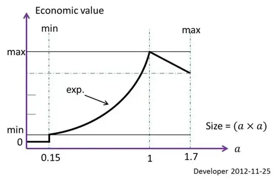

Size Constrains:
You may put some restrictions on the solution for the ultimate question, although, we believe it is always possible to add more later. For example, follow these: {2D case}
The best size of a block (economically optimum rectangle) to be extracted under the conditions mentioned above, is 1x1 m given 10x10 m for the region in the example. This is one constraint defined based on economical value. The minimum workable size for cutting etc, let be 0.15x0.15 m; so this the second size limit.
The figure above shows the economic value function depending to the block size. So for this particular case every rock piece smaller than 0.15x0.15 m is just waste. There will be no block size larger than 1.7x1.7 m due to operation limits.
