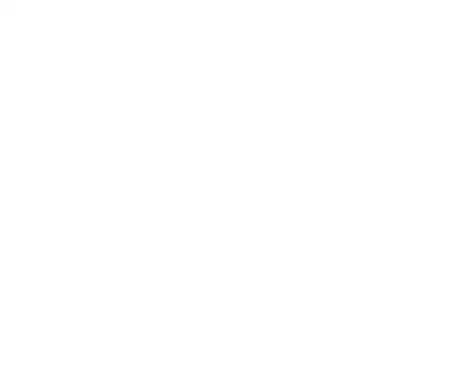

Ad Question 2: Let me illustrate the use continuing above train of thought. For $n=k=3$, we have the following Markov chain:
abstract HMM
[source]
$p_{i,j}$ is the probability to transition from state $i$ to state $j$; note that $p_{i,0}=0$ for all $i$ and those edges have been left out¹. Let $p_{i,\bot}$ the probability of terminating in state $i$ (we leave out another dummy state for clarity). $q_{i,l}$ is the probability to emit $l$ when entering (or, equivalently, leaving) state $i$; this models our feedback. Of course, we require $\sum_j p_{i,j} + p_{i,\bot} = \sum_l q_{i,l} = 1$ for all $i$.
Note that the state sequence $0,1,2$ has probability $p_{0,1} \cdot p_{1,2}$ -- that is a central property of Markov chains. The output sequence $1,2$, on the other hand, has probability $q_{0,1}\cdot p_{0,1}\cdot q_{1,2} + q_{0,1}\cdot p_{0,2}\cdot q_{2,2} + q_{0,1}\cdot p_{0,3}\cdot q_{3,2}$.
In a real world scenario, we would have to train our Markov chain. Let us assume we have some sequences of both state and output²:
$\qquad \begin{align} &(0,1), (1,1), (2,1), (3,1) \\ &(0,2), (1,3), (3,1) \\ &(0,1), (3,3), (1,2) \end{align}$
Now we just count how often each transition and output happened and set our probabilities to the relative frequencies³:
concrete HMM
[source]
Now you can do the interesting stuff. Ignoring the output, you can determine the path with highest probability, you can determine the output sequence with highest probability but most importantly, and here the hidden part comes into play, you can find the most likely state sequence given an output sequence with Viterbi algorithm.
