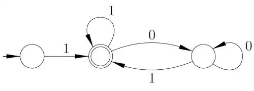

Actually that expression I obtained by starting with the FSA below, and realizing that the rightmost two states could be replaced by iterating $0^*1$.
