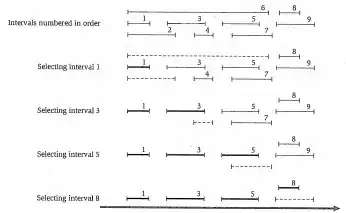

This is called the "Interval Scheduling" problem in the book [1]. The greedy algorithm, along with an example, is as follows (please find the correctness proof in the book mentioned above):
  • sort the intervals in increasing order of their finishing times, still denoted as $\mathcal{I}$.
  • while ($\mathcal{I} \neq \emptyset$) choose the first $I \in \mathcal{I}$, do:
    • add $I$ into the result-set; (darker lines in the figure)
    • delete all intervals from $\mathcal{I}$ that conflicts with $I$ (dashed lines in the figure).
interval-scheduling-example
[1]: Algorithm Design. By Jon Kleinberg and Éva Tardos. (Section 4.1)
