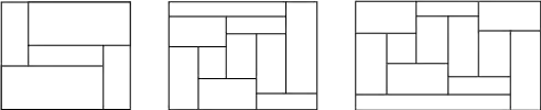

My interest is in generating rectangular partitions that satisfy these two conditions: 1- No two adjacent rectangles share a common side (i.e. the union of two adjacent rectangles is not a rectangle). 2- At most two corners meet at a point.
Similar partitions appear under other names that include rectangulations, Tatami tilings, and non-slicing floorplans.
What algorithms are there that generate random fault-free rectangular partitions?

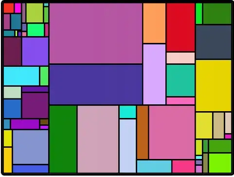

Update: Here is an example of random Mondrian rectangular partitions. Here the original rectangle is divided into two subrectangles. However, it is the opposite of what I want.
