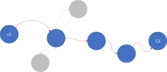

I attempted the following. I have the final route and I call edges, $m_1, m_2, ..., m_i$ and $e_1, e_2, ..., e_j$. Where $m_1, m_2, ..., m_i$ are the edges along the cities that are the farthest apart ($c1$ and $c2$) and $e_1, e_2, ..., e_j$ are everything else in the graph. As I start from $c1$, I travel along edges labelled m exactly once and everything else labelled e is a digression and go back and forth twice on those edges, before I reach $c2$.
We know that $m_1, m_2, ..., m_i$ and $e_1, e_2, ..., e_j$ taken together include all the edges on the graph (as it is a tree, there's only a unique path between every two nodes). So the distance I travel could be given as $2(e_1 + e_2 + .... + e_j) + (m_1 + m_2 + ... + m_i)$.
I need to prove that this sum is less than every other route that I can take to reach all the cities. My intuition says that this has to be the shortest route. I feel that have to use the fact that $(m_1 + m_2 + ... + m_i)$ is the maximum between any two nodes in the graph somehow (is that called the diameter ?), and arrive at a contradiction.
This is the kind of picture I have in my mind (red edges are in ($m_1, m_2, ..., m_i$) and the grey ones are everything else),
That graph is still a tree (please ignore the arrow head in the edges that show how I decide to travel). I don't to where to go from here. I would appreciate a proof that is simple to understand (This is not a homework or anything related to coursework.)

The other part of the proof is to show the journey can be as short as $\displaystyle{\sum_{e\in E}2e - \sum_{e\in P}e}$ for any path $P$, as indicated by the picture in the question. We can prove by induction on $n$, the number of nodes that is not on $P$. The base case when $n=0$ is clear. For the induction step, we can find a leaf that is not in $P$. (Pick any edge not in $P$, whose removal splits $T$ into two smaller trees. Pick any leaf in the smaller tree that does not contain $P$.) Then we can extend a journey that misses that leaf by inserting into that journey an excursion that goes to that leaf and then returns back.
