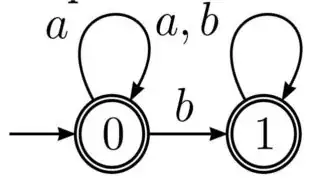

I was looking at the question How to convert finite automata to regular expressions? to convert DFA to regex.
The question, I was trying to solve is:
I have got the following equations:
$Q_0=aQ_0 \cup bQ_1 \cup \epsilon$
$Q_1=aQ_1 \cup bQ_1 \cup \epsilon$
When solved, we will get $Q_0=a^*b(a \cup b)^* \cup\ \epsilon$
But my doubt is that, in the DFA starting state is also the final state so, even if we dont give any $b$, it will be accepted, if we give some $a$. But in the regex we have $b$, instead of $b^*$. Why is it so? Is it because,we have that regex $\cup$ $\epsilon$ ?

I'll be using the solution to $Q = \alpha Q \cup \beta$ given by $Q = \alpha^* \beta$, essentially as you would go solving a system of linear equations by hand:
$$ \begin{align*} Q_0 &= a Q_0 \cup b Q_1 \cup \epsilon \\ Q_1 &= (a \cup b) Q_1 \cup \epsilon \end{align*} $$ From the first equation you have $Q_0 = a^* (b Q_1 \cup \epsilon)$, the second one reduces to $Q_1 = (a \cup b)^* \epsilon = (a \cup b)^*$. Replacing $Q_1$ in $Q_0$ gives: $$ Q_0 = a^* (b (a \cup b)^* \cup \epsilon) = a^* b (a \cup b)^* \cup a^* $$

Every state and every item from the set $\{a,b\}$ has a transition to another state, and every state is an accepting state. Therefore, all states are equivalent and the regular expression (in your notation) is just $(a ∪ b)^*$.
The automaton in question is equivalent to the following Kleene Algebraic fixed-point system of inequations: $$A ≥ a A + b B + 1,\quad B ≥ a B + b B + 1,\quad A,$$ with the last item, $A$, indicating the starting expression. The least fixed point solution for $(A,B)$, substituted into the starting expression $A$ yields the regular expression in question.
As you noted, you can factor $B$: $$A ≥ a A + b B + 1,\quad B ≥ (a + b) B + 1,\quad A.$$ You can solve for $B$. In general, the least fixed point solution to $x ≥ u x + v$, in $x$, which is denoted $μx·(ux + v)$, in Kleene algebra, is just $x = u^* v$. Thus, the reduction: $$A ≥ a A + b B + 1,\quad B ≥ (a + b)^*,\quad A.$$ Upon substitution for $B$ and elimination, this reduces to: $$A ≥ a A + b (a + b)^* + 1,\quad A.$$ In a similar way, we find the solution for $A$: $$A ≥ a^* (b (a + b)^* + 1),\quad A,$$ and, upon substitution and elimination of $A$: $$a^* (b (a + b)^* + 1).$$
(Your mistake, as already noted in another reply, is that you had the equivalent of $a^* b (a + b)^* + 1$, instead of $a^* (b (a + b)^* + 1)$.)
Kleene-algebraic identities can be used, particularly $(u + v)^* = u^* (v u^*)^*$ and $u^* = u u^* + 1$, reducing this to $$\begin{align} a^* (b (a + b)^* + 1) &= a^* (b a^* (b a^*)^* + 1)\\ &= a^* (b a^*)^*\\ &= (a + b)^*, \end{align}$$ or, in your notation $(a ∪ b)^*$.
