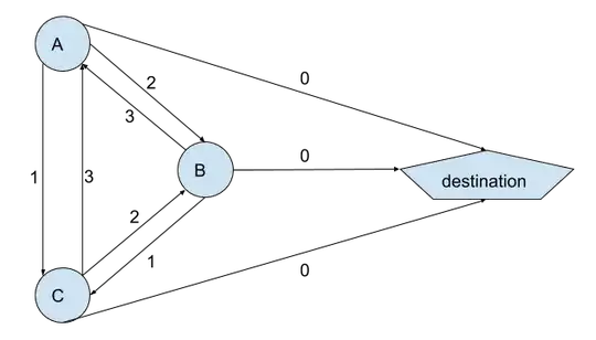

  1. I thought about a maximum flow problem (image 1). But the maximum flow problem deals with capacities in edges of a graph. This specific problem has limitations on capacities of nodes/cars (not in its edges).
Maybe there's an adaptation of this method that I can use, but I couldn't think of any that would give me the list of groups that minimize the number of cars.
Flow graph

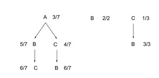

  1. Lastly, I considered creating a list of trees (image 3). Where each root would be the origin car, and each child node would be a car that the root could pick-up. For each level of depth the available seats of the root would decrease until no more combinations existed. Then I would group trees' levels together and try to achieve the best combination and minimum of cars.
But at what level do I start. Does starting at the tree with the greatest depth and then grouping with other trees guarantee the minimum number of cars? Or is there a counterexample where grouping trees in their respective mid levels achieve better clustering? Do I just need to try every possible combination? That seems like an exhausting comparison and awfully inefficient.
List of trees
