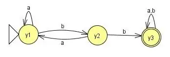

Consider these two FA
$FA_1$
FA1
$FA_2$
FA2
if $r_1,r_2$ and $r_3$ are regex for $FA_1,FA_2$ and $FA_3$ respectively where

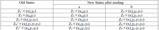

The Transition Table:
transition table for fa3

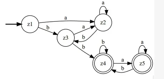

$TG_3$
TG3
Now, it'd be very tedious to explain how i created the transition table, it's easier to figure out by looking at it. but key point i can't quite grasp the "$x_1$ and $y_1$ being connected" part

In this case, $r_1r_2$ is indeed equivalent to $r_2$, and this is completely normal. A transition graph represents a transition function, which is part of an automaton. If you minimize $TG_3$, what you get is exactly $FA_2$, which confirms the equivalence.
