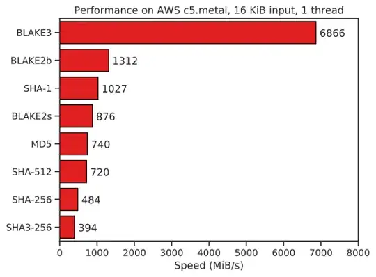

If one wants to have a faster mining system then the obvious choice is BLAKE3 and it is length extension attack free by design. Though BLAKE3 is a parallel hash, the performance is given on a single thread on the website of the BLAKE3.
