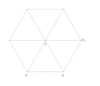

In euclidean space mirroring a triangle around point ($C$) would look like this:
Frist mirror $A$ at $CB$. Then mirror $B$ at $CA_M$ and so on. If it is a equilateral triangle it will match up again after doing this 6 times.

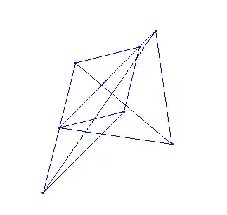

In a finite field $\mathbb F_{11}^2 $ it can look like this:
It also match up after doing this 6 times (around 1 point).
