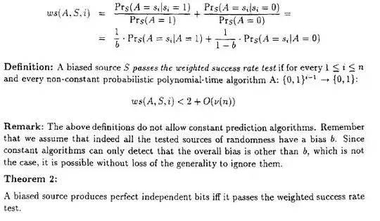

To summarize, they consider a source of biased but independent bits and how to devise a distinguisher for it. Note that without loss of generality they assume the probability of a $1$ bit is $b\in (1/2,1)$ but call the quantity $b$ the bias which is a bit counterintuitive, compared to the traditional use of bias for the quantity $b-\frac{1}{2}$.
In particular, they define a weighted success rate of any non-constant PPTA algorithm $$A:\{0,1\}^n\rightarrow \{0,1\}$$ in predicting the $i^{th}$ bit of a biased source as here
Note: The notation $f<O(\nu(n))$ is used for any function that vanishes faster than any polynomial reciprocal power, i.e., any vanishing function.
