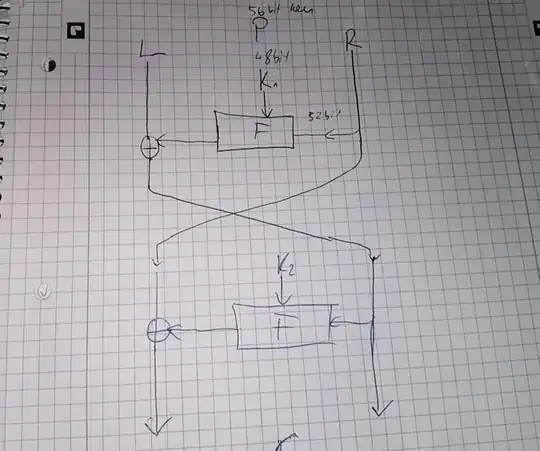

My idea was if we have plaintext-ciphertext pair we do the following. We split our ciphertext C in two 32bits. We have to guess K2 with 2^48 operations and then XOR L with output of F(K2,C) and compare with R of plaintext. If its equal we know K2 was correct. To make sure K2 was really correct, we can use other pairs to confirm it. Now we have to find K1, again with 2^48 operations. In total we need 2*2^48 operations rather 2^48 * 2^48 or better 2^56 operations. And we could easily use a distinguishing attack, by using weak keys of DES? and trying to find this L and R equality by only 2^48 operations. I might be totally wrong from the ground. Did I even draw the "2DES" cipher correctly? Structure of 2DES

Since the key is unknown to you, how are you going to mount a distinguishing attack? Think about that.
