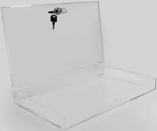

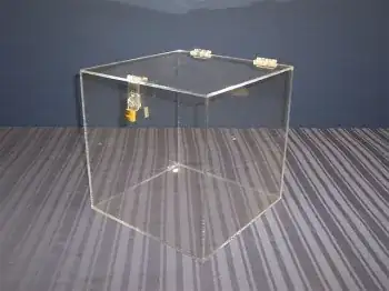

Here's another possible analogy: suppose you had an item in a clear acrylic display case that had a built-in lock, specifically one of those locks that required it to be locked with the key itself. Example:
Locking acrylic display case
Then someone without the key, upon coming across this case, could not verify that it was locked with a specific key, though they would know it was locked with some key. Someone with the "real" key could simply try to unlock the case, and if they succeeded, well, there you go.
This fits relatively well with a real MAC: the theoretical "algorithm" would be to use a case with the corresponding key(s). An attacker without the key cannot easily alter the document in question without alerting the key-bearer(s): any sort of brute-force physical attack on the case would likely leave marks on the case (e.g., saws, acid, etc.) The only exception would be lockpicking, but many physical analogues for other cryptographic primitives suffer from lockpicking too, so we'll ignore it.
There are a few inconsistencies, however: in a real cryptographic primitive, if the attacker has no knowledge of the scheme, the attacker may not necessarily know that a particular value is indeed a MAC tag. With the display case, however, it is quite clear that the document in question is protected, no matter how little an attacker knows. Further, with a real MAC, if you don't possess the key, you cannot verify the authenticity of the item in question. With the acrylic display case, you can pretty much look at it and figure out whether or not an unauthorized party has modified it: maybe someone took a bandsaw to the hinges to remove the door. That'd be pretty hard to miss.
On the other hand, as a third party looking at the display case, you don't necessarily know who have keys, so a bit of subterfuge could go unnoticed. Anyway, despite giving this matter a fair bit of thought, I have yet to come up with a better physical analogue, so take this as you will.

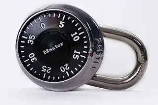

A padlock is a good analogy.
padlock
Consider a combination lock, where Alice and Bob know the secret combination. Alice can send Bob a message by writing down her message on a piece of paper, putting the piece of paper inside a metal chest, and locking the chest with the padlock. Then, Alice sends the chest by courier to Bob. Now Bob, who knows the combination, can open the combo lock and read Alice's message. No one else will be able to tamper with the message, since they don't know the combination to the lock. For example, the courier cannot tamper with the integrity of the message, since the courier doesn't know the combination. Here the secret combination plays the role of the MAC key.
If you want the analogy to be slightly closer to a MAC, make it a transparent chest (with no slits or openings in it), so anyone can see through the chest but can't touch or tamper with the paper inside.
clear chest
