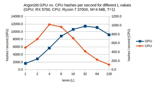

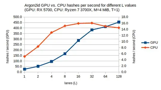

The following two graphs show the number of hashes per second for the GPU and CPU with different parameters.
The CPU speed increases until roughly the number of cores available. The 4 MiB (second) graph is a bit less accurate because it runs very fast.

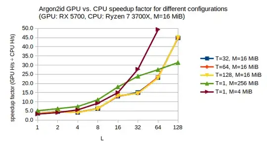

The next graph shows the speedup factor achieved with different parameters.
The speedup you get on CPU from using more lanes allows you to use more memory without taking more time (thus not annoying users more but getting a should-be-stronger hash). This should protecting better against a potential ASIC5, but it seems to weaken the protection from GPUs which typical attackers would actually use in practice.
