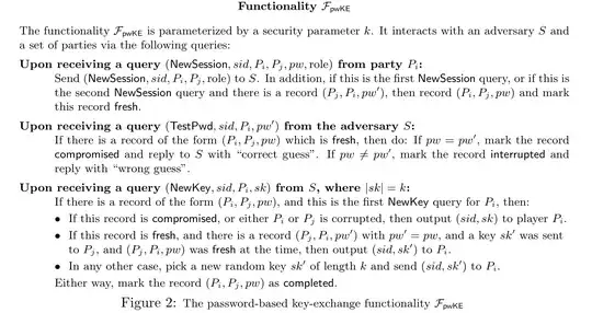

My intuition for the security a symmetric PAKE is supposed to provide comes from the example of a login page. Both the user and the server know the password (assuming unhashed passwords), and the purpose of the protocol is to authenticate both the user and the server to each other using this fact, while simultaneously generating a session key known only to them and avoiding any man-in-the-middle attacks. Specifically, I thought that one of the key properties of a PAKE is that the user and the server would get different keys if they provide different passwords, so a malicious party attempting to log in would be thwarted if it does not know the password. However, this does not seem to be the case according to the security definition.
The standard UC functionality for symmetric PAKE comes from Canetti et al.
Symmetric PAKE ideal functionality
Notice (top bullet under the $\textsf{NewKey}$ query) that if one of the parties is corrupted then the adversary gets to choose the session key $sk$, regardless of whether the two parties provided the same password. By using two queries to $\textsf{NewKey}$, the adversary can set both parties' session keys to be the same. Why would the definition be chosen to allow this? If the passwords differ, the functionality could instead have been written to give the adversary the power to choose only the compromised party's key, and not the honest party's key.

The paper contains text that explains why this is OK. I quote:
The main idea behind the FKE functionality is as follows: If both participating parties are not corrupted, then they receive the same uniformly-distributed session key, and the adversary learns nothing about the key except that it was generated. However, if one of the parties is corrupted, then the adversary is given the power to fully determine the session key. The rationale for this is that the aim of key exchange is to enable honest parties to generate a key that is unknown to an external adversary. If one of the participating parties is corrupted, then the adversary will learn the generated key (because it is one of the participants), and so the security requirement is meaningless. In such a case, there is nothing lost by allowing the adversary to determine the key.
However, from your question, I think I understand what you are worried about. If the adversary $P_k$ can set the value of its key with $P_i$ and with $P_j$ then it could seemingly behave like a man-in-the-middle between $P_i$ and $P_j$. However, this is not the case. Specifically, $P_i$ knows that its key with $P_k$ is $sk$, and when communicating with this key, it knows that the communication is with $P_k$ and not with $P_j$ (and vice versa). When $P_i$ wants to communicate with $P_j$, it has a different session key.
Bottom line, the reason that this doesn't matter is that the identity of the other party is given together with the key.
One more note: it may not be absolutely necessary to allow this, but there's no reason to disallow it. Disallowing it may rule out protocols that are perfectly fine. Therefore, it's better to allow it if there's no reason not to.

The question is essentially why the line
If this record is compromised, or either $P_i$ or $P_j$ is corrupted, then output $(sid, sk)$ to player $P_i$.
is used in the ideal functionality, rather than
If this record is compromised, $P_i$ is corrupted, or $P_j$ is corrupted and there is a record $(P_j, P_i, pw')$ with $pw' = pw$, then output $(sid, sk)$ to player $P_i$.
This change would make it clear that a malicious user $P_j$ cannot successfully run this protocol to log in to an honest server $P_i$ if it makes an incorrect password guess, even when there is no man-in-the-middle (MITM) attack. I still do not know the reason for the current ideal functionality, but I do know that it is equivalent to the proposed modification when the underlying communication ideal functionality allows MITM attacks. In particular, I will assume that the PAKE, like every PAKE I know of, is based on the unauthenticated channel functionality, where the adversary is allowed to view all of the messages and modify them arbitrarily.
Let $\newcommand\oldfunc{\mathcal{F}}\oldfunc$ be Canetti et al.'s ideal functionality, $\newcommand\newfunc{\mathcal{F}'}\newfunc$ be the modified ideal functionality, and $\newcommand\commfunc{\mathcal{F}_{UA}}\commfunc$ be the unauthenticated channel functionality. Assume there is a protocol $\newcommand\prot{\mathcal{P}}\prot$ that realizes $\oldfunc$ in the $\commfunc$-hybrid model, using a simulator $\newcommand\oldsim{\mathcal{S}}\oldsim$. Then there is a simulator $\newcommand\newsim{\mathcal{S}'}\newsim$ that shows that $\prot$ realizes $\newfunc$ in the $\commfunc$-hybrid model. If both $P_i$ and $P_j$ are corrupted, or neither are, then $\newfunc$ behaves identically to $\oldfunc$, so $\newsim$ can behave exactly the same as $\oldsim$ in this case.
If there is one honest party $\newcommand\honP{P_i}\honP$ and one corrupted party $\newcommand\corP{P_j}\corP$, then $\newsim$ imagines a scenario where $\honP$ is still present, but also there is a second honest party $\newcommand\imagP{P_k}\imagP$ and a MITM attacker $\newcommand\mitmP{P_j'}\mitmP$. Specifically, $\imagP$ inputs a uniformly random string in $\{0,1\}^\kappa$ as its password, and the MITM attacker $\mitmP$ drops and ignores all messages from $\imagP$, instead sending all messages from $\honP$ to the original dishonest party $\corP$ and vice versa. $\newsim$ asks $\oldsim$ to simulate the environment's view for this scenario. It then forwards $\oldsim$'s queries to the ideal functionality, except that all queries mentioning the imagined honest party $\imagP$ are ignored, replaced with replies of "wrong guess" in the case of $\newcommand{\ucsymbol}[1]{\textsf{#1}}\ucsymbol{TestPwd}$ queries.
