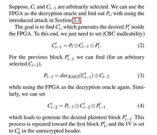

I'm struggling with understanding this part of the literature:
It can be assumed that the entire ciphertext AND plaintext is known.
Considering the encryption method is $C_i = enc_k ( P_i \oplus C_{i-1})$ with a key k, and the decryption method is $P_i = dec_k(C_i) \oplus C_{i-1}$.
Why does it say in equation (2) say that we can generate the desired ciphertext of the previous block this way?
Also shouldn't the equation (3) formula be: $P'_{i-1} = ...$ instead of $P_{i-1} = ...$
I don't really get equation (4) and why is it different from equation (2)?
Any help appreciated.

  1. Why does it say in equation (2) say that we can generate the desired ciphertext of the previous block this way?
Actually, it is the goal and they show it in the next steps. Therefore, you need to understand the next steps.
  1. Also shouldn't the equation (3) formula be: P′i−1=... instead of Pi−1=...
Yes it should be $P'_{i-1}$
Note that for arbitrary selected $C_i$ and $C_{i-1}$ using the decryption oracle one can find out $P_i$.
Now you want a value $P'_i$ in the FPGA and for this, you need the encryption of it $C'_i$.
$$P_i = dec_{KAES}(C_i) \oplus C_{i-1} \label{1}\tag{1}$$
If you set
$$C'_{i-1} = P_i \oplus C_{i-1} \oplus P'_i \label{2}\tag{2}$$
Then put values into equation \ref{1}
$$P_i = dec_{KAES}(C_i) \oplus P_i \oplus C'_{i-1} \oplus P'_i$$ leaves;
$$P'_i = dec_{KAES}(C_i) \oplus C'_{i-1} $$
CBC has the chaining so they need to modify to the beginning.
$$P'_{i-1} = dec_{KAES}(C'_{i-1}) \oplus C_{i-2} \label{3}\tag{3}$$
  1. I don't really get equation (4) and why is it different to equation (2)?
This is also a typo, since
$$C'_{i-2} = P_{i-1} \oplus C'_{i-2} \oplus P'_{i-1} \label{4}\tag{4}$$ leads
$$ P_{i-1} = P'_{i-1}$$
It should be
$$C'_{i-2} = P_{i-1} \oplus \color{red}{C_{i-2}} \oplus P'_{i-1}$$
