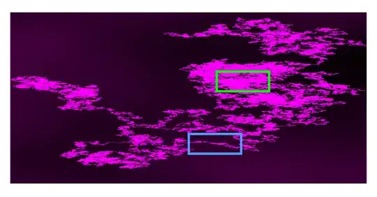

This need to be changed to a $p$ value of the certainty that whatever randomness test suite (NIST STS, TestU01, diehard, dieharder, ent, AIS-31, pkzip, FIPS 140 etc.) you run is accurate. It ranges 0 - 1, and 'famously' we tend to exclude values within 1% - 5% of the tails (suite dependant). And you do get $p = 0.0005$ as false negatives because imagine an output domain like (it's a TRNG random walk):-
domain
If you test the blue box, the data is appears highly biased and it fails. If you test the green box, as the data is uniform it passes. And yet it's a good TRNG overall. Randomness is pesky like that.
