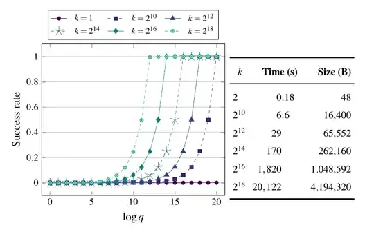

With SageMath code they were able to find $k=2^{16}$ colliding ciphertext very quickly. They simulate their adaptive partitioning oracle attack that constructs splitting ciphertexts of size $k$ iteratively for different sets of keys until the oracle returns valid. At this point, the adversary performs a binary search in $\log k$ queries to find the secret.
On the left, on the above picture, their success rate, and on the right is the time to generate the $k$-way collisions.
It turns out that multi-key collision attack on the Poly1305 is harder than GCM due to the appended 0x01. They are only able to generate at most 10, compare to GCM that reaches 18 degrees. this still gives a factor- of-ten speedup in partitioning oracle attacks

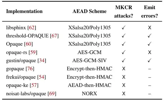

  1. In an example local application where one uses say, libsodium's secret box (Xsalsa20+Poly1305) and Argon2 to derive a password and encrypt some file, if this file is stored on a system with no other API or info, is this vulnerable to this attack? (e.g. by calling libsodium and watching if the MAC primitive is successfully verified) or are "offline/stored" files like this safe? i.e. like a padding oracle attack, does this whole thing require that the server knows the correct key, and as such can give away information?
This attack requires an oracle that returns a value like the padding oracle attacks. If there is no return, then there is not a test even for a normal online password guessing attack $k=1$. They have looked at the libraries the use OPAQUE and AEAD schemes and saw that some of them are not applicable. See the emits error column. The attack on Shadowsocks was interesting since the attacker had a side channel to test.
