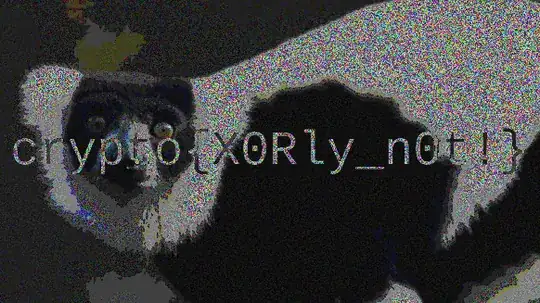

As mentioned by @r3mainer, I get this result from the code below using PIL library.enter image description here
from PIL import Image, ImageChops
im1 = Image.open('lemur.png')
im2 = Image.open('flag.png')
im3 = ImageChops.add(ImageChops.subtract(im2, im1), ImageChops.subtract(im1, im2)) im3.show() #im3.save("Your_path/im3.png")
I alter the code found on this link to be more explainable.
My code calculate abs(a-b) while the description of a XOR b using arithmetic in this link is (a-b)^2. They produce the same value when a and b is either 0 or 1.
Normally, a picture has RGB color channel which each of them is treated as 8-bit integer. This code, ofcourse, doesn't give the result as R3 = R1 XOR R2 (if R1 from R channel of picture 1 and so on). But I code this way because I couldn't find any decent arithmetic expression that can really substitue the XOR operation and that I check with this link and it can produce the same result so I think it should works.
