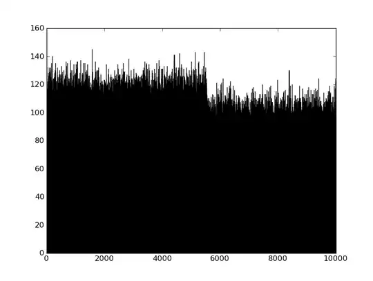

First, how not to do it. You could generate 2 bytes, treat it as a 16 bit number and compute it modulo 10000. That would give you a number between 0 and 9999, but would not be cryptographically secure. It would have bias. For example, using python random.randint(0,65535) % 10000, I generated 1,000,000 random numbers and plotted the following histogram:
Bad PRNG

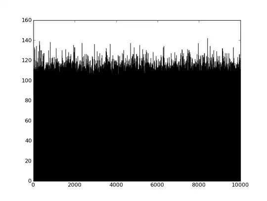

Good PRNG
