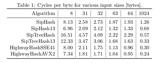

You can use HighwayHash. It is a fast SIMD-based keyed hash function (5x faster than SipHash) with security claims and suitable for hashing short inputs.
