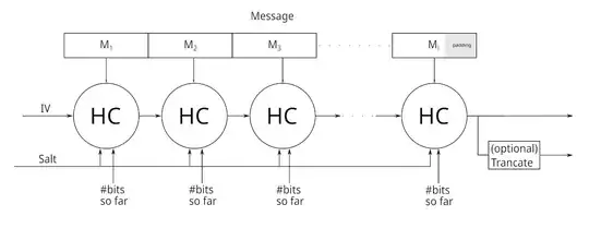

HAIFA design
The compression function of HAIFA is designed as
$$C:\{0,1\}^{m_c} \times \{0,1\}^n \times \{0,1\}^b \times \{0,1\}^s \to \{0,1\}^{m_c}$$ or
$$h_i = C(h_{i-1}, M_i, \#bits, salt)$$ $\#bits$ is the number of bits hashed, $h_0 = IV$, and $salt$ is the usual salt value.
The padding scheme
It is bit padding, add 1 then and as many as 0 then the length encoded in $t$ bits, then the digest size encoded in $r$ bits. Therefore the added 0 is $ \equiv n - (t+r-1) \mod n$
Security
Collision resistance: Similarly to MD, they have proved that if the underlying compression function is collision resistance the HAIFA construction, too.
Fixed point countermeasure: the inclusion of the number of bits hashed so far prevents the fixed point attacks.
Randomized hashing is achieved by the salt.
Multi-collision attack: The attack still works, however, the inclusion of the salt prevents pre-computation
The Hearding attack: The precomputation is infeasible if the salt is unknown.
