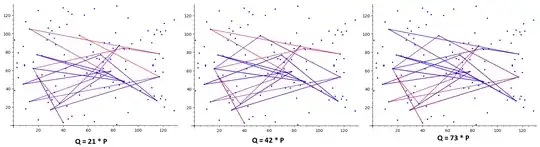

My First Attempts:

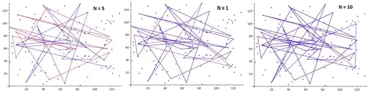

So I did some testings on the curve $E: y^2 = x^3 + x^2 + x$ with $F_{131}$ and the points $P = (42,69)$ and $Q = 42 \cdot P$. My results for different $N$:

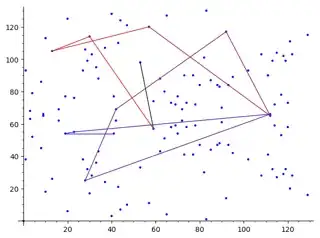

My result for a different Hash function:
So this got me confused, because I did not see any results for different N and I thought only the hash-function is for optimization. But the real answer is much more complex. My sources are wikipedia, handbook of elliptic and hyperelliptic curve cryptography and the original paper.
Answers:
  1. Yes, the hash-function is a semi-random number generator. But it is important for the algorithm! The runtime of the algorithm and the failure rate depends on the hash-function. If the result set is to small, the runtime gets pretty bad. If the result set is to big, the failure rate increases. With the handbook I got the result set $\{ 1,2,..., \sqrt{(b-a)}/2 \}$ and it works pretty good.
  2. I found the answer in the origional paper: $N$ defines the failure rate. If $N$ is low, the failure rate is bigger. So that's the reason I did not see significant changes in the plots. Hint: I still have no idea, if I have to store all intermediate results of the tame kangaroo or not. ( I will edit the post, if I find the answer )

This now always generates a pretty reasonable plot for the wild kangaroo (same curve and basepoint):enter image description here
