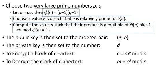

enter image description here So I've been studying RSA for a class and I'm having a hard time understanding how it works. Why do we choose the value of e such that e is relatively prime to the totient (as opposed to just being relatively prime to n?) How does e being relatively prime ensure that there is only one possible value for d? And are the calculations based on the totient of n just an arbitrary way of encrypting or is there significance to them?
Also, if both e and n are public then how is that secure at all (or is this article wrong about e being public?) I guess I'm confused because if everyone is receiving the same public key then isn't the inverse operation going to be the same for everyone and thus not secure? And since we know that ed mod totient(n) = 1, and we know both n and e can't d easily be calculated?
