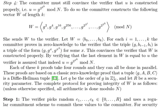

In the following paper (page 5) they have a proof that a triple $\left(g,b_{i-1},b_{i}\right)$ is of the form: $\left(g,g^{x},g^{x^{2}}\right)$ for some x.
The relevant text from the paper is as follows:
They say the protocol is based on a classic proof that a tuple is a DH tuple, however I don't agree because I think they're missing a fundamental issue:
In the ZKP of a DH tuple, the order of g is known, however, here - the order of g is not known because it might leak information about $\phi(N)$.

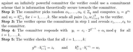

So assume that we have 2 different transcripts with the same $z_{i},w_{i} $ but different challenges $c_{i},c'_{i}$ that the verifier accepts.
Thus, the following equations hold:
$(1)~\,g^{y_{i}}\cdot b_{i-1}^{-c_{i}}=z_{i}$
$(2)~b_{i-1}^{y_{i}}\cdot b_{i}^{-c_{i}}=w_{i}$
$(3)~ g^{y_{i}'}\cdot b_{i-1}^{-c'_{i}}=z'_{i}$
$(4)~ b_{i-1}^{y'_{i}}\cdot b_{i}^{-c'_{i}}=w'_{i}$
From the first equation and the third equation we get that:
$g^{y_{i}}\cdot b_{i-1}^{-c_{i}}=g^{y_{i}'}\cdot b_{i-1}^{-c'_{i}}$ , thus $g^{y_{i}-y'_{i}}=b_{i-1}^{c_{i}-c'_{i}}. $
However, now I'm stuck because I cannot find $\left(c_{i}-c'_{i}\right)^{-1}mod\,\phi(N)$ because I don't know $\phi(N)$ in the first place (as an efficient witness extractor), nor I can do some kind of $gcd(a,b)=1$ trick .

How do you prove the soundness property of the ZKP from the paper without witness extraction (which seems not possible)?
It is perfectly possible and you've almost done it already! You are right that unknown order groups make your life very complicated when you want to build proofs of knowledge - we know results in this direction (the one you cite) -- although it should be mentioned that they break down as soon as you use a CRS (e.g. as we did in this paper).
But if you only want soundness and not the stronger knowledge extraction, you do not need to compute this cumbersome $(c_i-c'_i)^{-1}\bmod \varphi(n)$.
Let $z_i \gets y_i - y'_i$ and $d_i \gets c_i - c'_i$.
From equations (1) and (3), you get $g^{z_i} = b_{i-1}^{d_i}$.
From equations (2) and (4), you get $b_{i-1}^{z_i} = b_{i}^{d_i}$.
Therefore, it is necessarily, mathematically true that there exists an exponent $x$ such that $g^x = b_{i-1}$ and $b_{i-1}^x = b_i$. Indeed, this $x$ is equal to $z_i\cdot d_i^{-1}\bmod \varphi(n)$. So sure, you can't compute it - but the fact that it exists suffices to prove soundness of the protocol! In other words, $(z_i, d_i)$ still constitute a certificate that the word is in the language, which you can extract whenever the prover produces an accepting proof. This certificate is not a witness with respect to the target relation, but it's existence still suffices to guarantee membership to the language.
