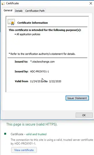

You can (and many developers do) add your own root certificate to your computer's trusted roots. In this case, you can use the certificate to sign other certificates for development and your browser and apps on your computer or another computer with your certificate installed as a trusted root certificate will happily show the connection as secure.
So you go to https://www.mybank.com in your browser and your browser receives a certificate. This certificate has a chain of trust. In Chrome you can go to the developer console Security tab and view the certificate and the chain of trust, which will lead up to a trusted root certification authority. On windows 10 you can see your computer's certificates with "Manage Computer Certificates".
Notice what mine says for this site:
HDC-PROXY01-1 is a weird address to issue a certificate to stackexchange.com, eh? Turns out my connection is being attacked with a MITM attack by my employer who snoops on everything I do at work. The computer they provided me with has the company's own certificates installed as 'Trusted Root Certification Authorities' for just this purpose. Their proxies can intercept secure connections and provide their certificates instead of the ones belonging to the site you are going to, proxy the data over a secure connection to the site using the site's actual certificate, and re-encrypt the data with the proxy certificate before sending it back to me. My browser trusts the proxy's certificate because it was signed with the company's certificate in my trusted store.
