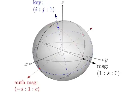

The geometric picture of the GMS scheme is that:
  • a $\text{message}$ is a line (drawn in solid black) through the origin that hits the equator (drawn in grey at $z = 0$),
  • a $\color{blue}{\text{key}}$ is a line (dashed blue) through the origin that doesn't hit the equator, and
  • an $\color{red}{\text{authenticated message}}$ is a line (dotted red) through the origin perpendicular to both message and key.
Gilbert–MacWilliams–Sloane one-time authenticator in projective space
For any fixed message, every corresponding authenticated message under any key passes through the great circle perpendicular to that message (solid black)—but to know which line through that great circle requires knowledge of the key. For any fixed key, every authenticated message under that key passes through the great circle perpendicular to that key (dashed blue)—but knowing one line through that great circle doesn't help to find any other line through that great circle for a forgery because there are many great circles that the authenticated message passes through and any one of them could correspond to the true key.

Appendix: Asymptote code for the diagram
import three;
size(10cm, 0);
triple msg = (1, 4, 0);         // (1 : s : 0)
triple key = (1/2, 1/5, 1);     // (i : j : 1)
real tag = ypart(msg)*xpart(key) - ypart(key);
triple authmsg =                // (-s : 1 : si - j)
  (-ypart(msg), 1, tag);
void
drawaxis(triple A, string text, align align)
  Label L = Label(text, position=EndPoint, align=align);
  draw(O--1.5A, arrow=Arrow3(TeXHead2), L=L);
drawaxis(X, "$x$", align=W);
drawaxis(Y, "$y$", align=E);
drawaxis(Z, "$z$", align=N);
draw(circle(c=O, r=1, normal=Z), p=gray(0.5));
draw(1.5 unit(msg) -- 1.5 unit(-msg), arrow=Arrows3, p=black,
  L=Label("\noindent msg:\\$(1 : s : 0)$", position=BeginPoint, align=SE));
dot(unit(msg), p=black);
dot(unit(-msg), p=black);
draw(1.5 unit(key) -- 1.5 unit(-key), arrow=Arrows3, p=blue + dashed,
  L=Label("\noindent key:\\$(i : j : 1)$", position=BeginPoint, align=NW));
dot(unit(key), p=blue);
dot(unit(-key), p=blue);
draw(1.5 unit(authmsg) -- 1.5 unit(-authmsg), arrow=Arrows3, p=red + dotted,
  L=Label("\noindent auth msg:\\$(-s : 1 : c)$", position=EndPoint, align=S));
dot(unit(authmsg), p=red);
dot(unit(-authmsg), p=red);
draw(circle(c=O, r=1, normal=msg), p=black);
draw(circle(c=O, r=1, normal=key), p=blue + dashed);
draw(circle(c=O, r=1, normal=authmsg), p=red + dotted);
draw(
  0.2 unit(key) -- 0.2 (unit(key) + unit(-authmsg))
    -- 0.2 unit(-authmsg),
  p=gray(0.5));
draw(
  0.2 unit(msg) -- 0.2 (unit(msg) + unit(-authmsg))
  p=gray(0.5));
draw(unitsphere,
     surfacepen=material(white + opacity(0.5), ambientpen=white));
