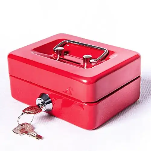

Note: If you consider a trapdoor is bad for ages 11-13 you can go for locked cash boxes;
Instead of money use messages.
