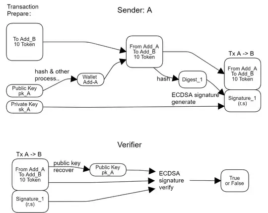

I have been studing ECDSA signature/verify for a while. By my understanding: the standard ECDSA signature/verify process (which we find on text book) are like below: enter image description here - A sender combines message and its ECC public key (pk), do hash, then using ECC sk (private key) to generate signature; it then append the signature with the message (ECC pk include), send all these to receiver;
  • The receiver do ECDSA verify by using the ECC pk, the message and the signature output true or false;

Thanks so much for help from @Changyu Dong.

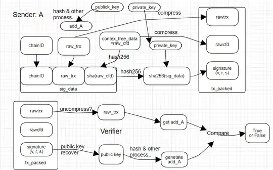

Here I'd like to put another chart to show my understand to a EOS based ECDSA Tx sign and verify process.. If anything not right please just correct and further discuss is welcome..
The EOS client signing process refer to a lot from here: https://eosforce.github.io/Documentation/#/zh-cn/eosforce_client_develop_guild?id=_3-%e4%ba%a4%e6%98%93
