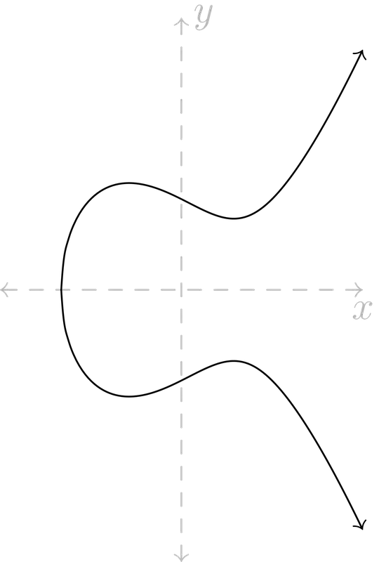

You can think of the point at infinity as an extra point kludged into the set to make the curve work out as a group, but that's a little unsatisfying: in the geometric picture of a curve there's no place for the point at infinity, and in the algebraic construction the point at infinity is this weird magic object $\mathcal O$ with no coordinates.
$$E := \{ (x, y) \in k^2 \mid y^2 = x^3 - x + 1 \} \cup \{\mathcal O\}$$
y^2 = x^3 - x + 1

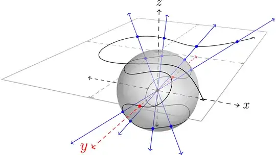

Instead, it is better to think of things in projective coordinates: $$E := \{ (X : Y : Z) \in \mathbb P^2(k) \mid Y^2 Z = X^3 - X Z^2 + Z^3 \}.$$ Here the notation $(X : Y : Z)$ means the set of all triples $(\lambda X, \lambda Y, \lambda Z)$ for some $\lambda \in k$, or equivalently the line in the three-dimensional space $k^3$ that passes through the origin $(0, 0, 0)$ and the point $(X, Y, Z)$, provided at least one of $X$, $Y$, or $Z$ is nonzero. Notice that I didn't write $\cdots \cup \{\mathcal O\}$: as it happens, there is a natural set of projective coordinates for the point at infinity, namely $(0 : 1 : 0)$ (or $(0 : 2 : 0)$, or $(0 : 128364/2486 : 0)$, etc.).
Not only is there a natural set of projective coordinates, but there is a geometric picture too. If we paste the picture above on the plane $z = 1$, we are taking the intersection of all the projective lines $(X : Y : Z)$ satisfying $Y^2 Z = X^3 - X Z^2 + Z^3$ with the affine points $(x, y)$ satisfying $y^2 = x^3 - x + 1$ pasted on the plane $z = 1$—all except for one such projective line:
The one exception is the $y$ axis, $(0 : 1 : 0)$, which is exactly the point at infinity! If you draw lines from the origin to the affine curve pasted on the plane $z = 1$, that is if you map $(x, y) \mapsto (x : y : 1)$, as you get further and further out the wings of the curve, the line gets closer and closer to the $y$ axis—along both wings! In the limit toward infinity, which has no affine coordinates, you just get the $y$ axis $x = z = 0$. For every other point, affine coordinates can be computed by $(X : Y : Z) \mapsto (X/Z, Y/Z)$.
So while it doesn't show up in the affine picture, the point at infinity has a natural geometric and algebraic interpretation in projective coordinates of lines through the origin.
