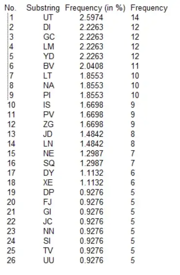

In order to decrypt this text I tried the following method:
1) Removed all spaces, dashes, commas, etc.
2) Divided the text into digrams.
3) Found the most common digrams, which are shown in the picture below:
4) Knowing that the most common digrams in English are "th" and "he", I tried mapping different combinations of ciphertext digrams to "th" and "he" (for example, "th" -> "ut" & "he" -> "lm"), which gave me a 2x2 plaintext matrix and a 2x2 ciphertext matrix.
5) I solved the equation $K = C*P^{-1}$ (mod 26)
I repeated these steps for many different mappings to "th" and "he". Sometimes I could not invert $P$ and sometimes the $K$ was invalid. Looking at the ciphertext I believe it is very likely that "th" -> "ut", since it appears at the beginning of so many 3-letter words.
Could anyone please help me with this? Is there something I am doing wrong? Is the way to solve it to just keep mindlessly trying new combinations?
