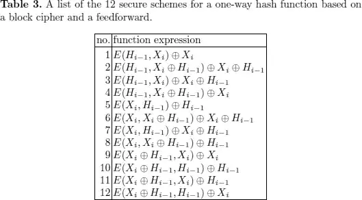

Some ideas (not a definitive answer):
  1. Davies–Meyer is one of the two simplest among the 12 secure methods by which a block cipher and XOR can be turned into an iterative hash with one encryption per block, per the analysis of Bart Preneel, René Govaerts, Joos Vandewalle's Hash functions based on block ciphers: a synthetic approach, in proceedings of Crypto 1993.
    table 3
    Note: in the above table, the block cipher $E$ uses its first argument as key.
  2. Davies–Meyer (method 5) is the only of the 12 that works with a block cipher having a key of width different of its block without needing an adapter (the g in the first drawing of the question).
  3. When the key is wider than the block, that characteristic 2 makes Davies–Meyer use less encryptions for large messages, and that can translate into a speed advantage.
  4. MD4, which was influential on MD5, then SHA, SHA-1 and SHA-2, essentially used Davies–Meyer (except for replacement of XOR with modular addition on a word).

The paper “The Maelstrom-0 hash function” [Filho D., Barreto P., Rijmen V.] presents Maelstrom-0 (as “an evolution of the Whirlpool hash function”). This paper contains the following information (see section 3):
Davies-Meyer is likely the most widely employed compression function in any concrete hash proposal. But more importantly, it is the only compression function among the 12 secure constructions analysed (in the context of a single-chain iterated hash function) by Black et al. [Black et al. 2002] that naturally allows the underlying block cipher to accept a key size different from the block size; all the remaining 11 functions XOR the key and the data block, thus forcing either truncation or padding to cope with the different sizes, and it is unclear to what extent truncation or padding might adversely affect the security analysis.
Quantitatively, the Miyaguchi-Preneel scheme is slightly more secure (by a roughly constant factor) than Davies-Meyer, but this difference is offset by the extra flexibility in the choice of the block cipher structure, which allows for faster hashing with the use of double-length keys.
