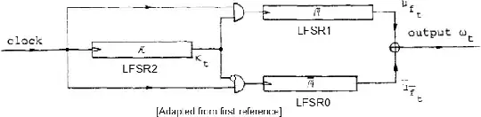

The ASG combines three Linear Feedback Shift Registers. To produce a bit:
- advance LFSR2
- according to its low-order bit, advance LFSR0 or LFSR1
- output the XOR of the low order bits of LFSR0 and LFSR1
The key is the initial state of the LFSRs (assumed to be random and independent bits, save for the state of each LFSR not being all-zero). It is customary to use primitive binary polynomials of distinct degree $n_i$. In the initial exposition, LFSR2 is modified to generate a de Bruijn sequence, that is the output sequence has an extra zero inserted after $n_2-1$ consecutive zeroes. But this detail makes no cryptanalytic difference, since that point in the sequence is reached with negligible probability for $n_2$ large enough for security.
