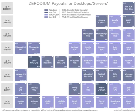

Or, you try to cash in on it.
If you're any good at finding flaws, there is a lucrative (and legal) yet very grey market in vulnerabilities and zero day exploits. The New York Times have listed some prices and companies that resell these. Outfits like Zerodium in Washington; Netragard in Acton, Mass.; Exodus Intelligence in Austin, Tex.; and ReVuln, and a Virginia start-up named Endgame. Typical exploits sell for 35,000 to 160,000 dollars, but you can get up to 500,000 dollars for Apple’s iOS.
All of the security agencies pay to get these, presumably under some form of non disclosure agreements/secrecy legislation. The NSA seems to be the largest client, but the FBI also buys exploits such as for back dooring Firefox/Tor. If you're really good, you should be able to sell the same exploit to multiple buyers. It depends on your contacts as to whether you are able to access this market though.
In the war on terror, it could literally be catastrophic to not exploit such flaws. Hawks would argue that it's your patriotic duty to pass such information onto the security agencies. Stuxnet, Flame and Duqu have all capitalised on zero day exploits with great success at disrupting Iran's nuclear program. It's to protect the children too. Or so the ideology goes. As the whether it's moral/ethical, those issues have been formalised by Obama's Special Assistant to the President and Cybersecurity Coordinator, Michael Daniel:-

Update:
Latest (March 2019) NY Times estimate of this market now puts it at \$12B. Salaries >> \$200,000 working for companies like Darkmatter or NSO Group breaking WhatsApp and Skype traffic.
Update2:
Zerodium is now offering up to $2,500,000 per exploit. Ka-ching:-
