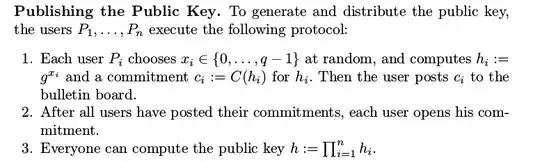

I am trying to implement a distributed encryption system by having as a main source of information this book (Introduction to Cryptography by Delfs and Knebl) and this Internet article (More Mix than Net by Wood).
I generate the following variables:
  • $p$: prime,
  • $g$: generator,
  • $x$: random within $[1, p-1]$,
  • $h$: $g^x \bmod p$
I can then use these variables to successfully encrypt, re-encrypt, and decrypt a message.
I am now trying to make the system use multiple authorities by following subsection 4.5.5 on Delfs's book that states:
According to this subsection $x$ is computed as a random number between $1$ and $q-1$, yet I am using the range $1$ and $p-1$ as shown in the article. Another difference is that in the book there is no mention of modulo $p$ when computing $h$.
Note that I have also implemented the ElGamal system as described in the book, but I would like to go with the implementation from the article since it makes more sense to me and I would like to not use external libraries).
My question is, what is the commitment I should generate and how can I later verify it?

I can't access the book, so not sure exactly what it says, but the article you referenced also seems to be generating values in a group with order q: my intuition is that they are just using separate variables and group is of the same size in both texts just using $q$ and $p$ as variables respectively. As long as you are sampling $x_i$ uniformly from the full modular group you should be okay.
A for using modulo p, the security of El Gamal relies on the hardness of discrete log within the group $G$ with order $p$, so all operations are bounded via $\bmod p$.
Hope this is helpful, did I understand your question correctly?
FreshPeter
  • 66
You can use a hash based commitment scheme, which is very simple to implement. The downside is that it is not easy to do zero-knowledge proof with the commitments. But from what you have given in the question, this does not seem to be a problem.
Let $\lambda$ be the security parameter (e.g. 128), let $H$ be a cryptographic hash function:
1 To commit, generate a $\lambda$-bit uniformly random string $r$. Then compute the commitment $C(h_i)=H(h_i||r)$.
2 To open a commitment $c=C(h_i)$, reveal $(h_i,r)$ and others can verify and accept if $c=H(h_i||r)$.
