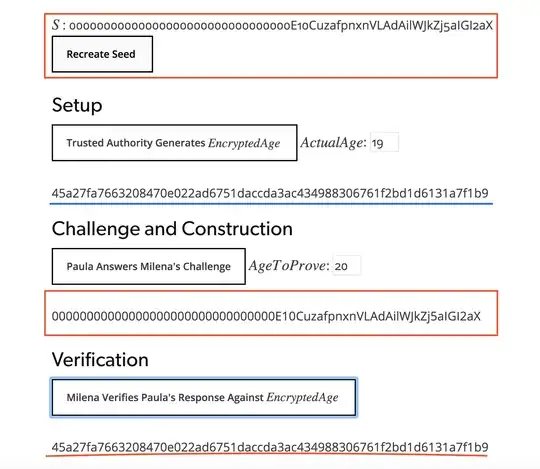

I think there is a flaw in the protocol, it occurs in this step:
Proof=HASH ^ {1+ActualAge−AgeToProve} (S)
When 1+ActualAge is equal to AgeToProve, then hash is not applied on S.
  1. It ends up sending the secret as Proof. S should have been maintained as secret.
  2. It ends up computing that verified Age == encrypted age, where as it is not, example: https://repl.it/repls/OrderlyPalegreenScriptinglanguages
The below is example from the blog, with Age = 19, and AgeToProof = 20:

Anyway, it turns out that, while the protocol as designed (and reasonably interpreted) is sound as far as I can tell, the JS implementations linked from the blog post and from your question are both buggy.
In fact, both of them have two bugs: one of that allows the prover to generate a bogus proof for a minimum age one year greater than their true age (revealing their secret seed in the process), and another bug that allows the verifier to accept it.
The first bug is simply that the prover should never attempt to generate a proof for a minimum age that they don't actually meet. A minimal fix to the code linked from the blog post would be to add the following like to the beginning of the challenge() function:
function challenge(age, age_to_prove) {
  if (age < age_to_prove) return null;  // <- ADD THIS LINE!
  Q = hashchain(S, Number(age)+1-Number(age_to_prove))
  document.getElementById("display_Q").innerHTML = Q
  return Q
A similar bug is also present in the prove() function in your code, and can be fixed the same way.
The second bug is that, even if the prover (deliberately or by mistake) tries to use their initial hash chain seed as a proof of age, the prover must not accept it. The blog post does correctly note this in the "Soundness" section:
The exception to this is for $AgeToProve=ActualAge+1$, in which case Paula could just send $S$. However, as the format of $S$ is publicly known, a watchful verifier would detect the fraud [...]
but the linked JS code doesn't actually include such a check. As a result, the verifier in the demo will happily accept the seed $S$ as bogus proof of age (and, due to the first bug, the prover will in fact respond with the seed if asked for a proof of a minimum age greater than their true age).
The blog post also uses a rather unfortunate choice for the format of the initial secret seed: 128 zero bits followed by 128 random bits, for a total of 256 bits. The reason this choice is bad is that it precisely matches the output bit length of SHA-256, making it theoretically possible (even if extremely unlikely) for a genuine SHA-256 output to match the format of the secret seeds. Literally any other choice of seed length (including just leaving out the 128 zero bits) would've avoided this issue.
Anyway, sticking with the poorly chosen seed format, a basic fix for the verify() function would be to add something like the following check at the top of it:
if (Q.length != 64 || Q.substr(0,32) == '00000000000000000000000000000000') {
  // this does not look like an SHA-256 output; verification failed!
  return null;
Of course, if the format of the secret seed was changed so that it wasn't exactly 256 bits (= 64 hex digits) long, then the .substr() check could be removed. And also, of course, if the protocol was simplified (at the cost of removing the option for exact age verification) so that the prover never learned the secret seed to begin with, then this check would not even be necessary.
