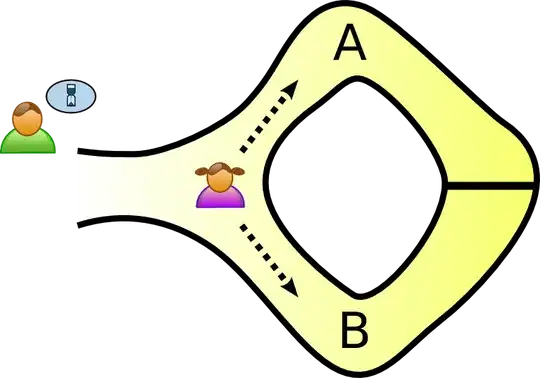

I find Ali Baba's Cave case to be good example to explain zero knowledge proof: https://youtu.be/0Sy6nb72gCk?t=3m46s
There is good summary on Wikipedia: https://en.wikipedia.org/wiki/Zero-knowledge_proof#The_Ali_Baba_cave
[...] In this story, Peggy has uncovered the secret word used to open a magic door in a cave. The cave is shaped like a ring, with the entrance on one side and the magic door blocking the opposite side. Victor wants to know whether Peggy knows the secret word; but Peggy, being a very private person, does not want to reveal her knowledge (the secret word) to Victor or to reveal the fact of her knowledge to the world in general. They label the left and right paths from the entrance A and B. First, Victor waits outside the cave as Peggy goes in. Peggy takes either path A or B; Victor is not allowed to see which path she takes. Then, Victor enters the cave and shouts the name of the path he wants her to use to return, either A or B, chosen at random. Providing she really does know the magic word, this is easy: she opens the door, if necessary, and returns along the desired path. However, suppose she did not know the word. Then, she would only be able to return by the named path if Victor were to give the name of the same path by which she had entered. Since Victor would choose A or B at random, she would have a 50% chance of guessing correctly. If they were to repeat this trick many times, say 20 times in a row, her chance of successfully anticipating all of Victor's requests would become vanishingly small (about one in a million). Thus, if Peggy repeatedly appears at the exit Victor names, he can conclude that it is very probable—astronomically probable—that Peggy does in fact know the secret word. [...]
Ring with Peggy and Victor -- Image by Dake~commonswiki
