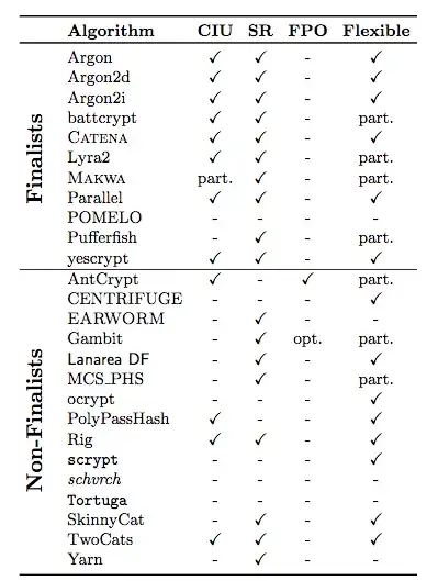

An overview:
List of password hashes and whether they have CIU
