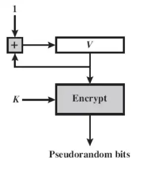

This is probably one of those embarrassingly simple questions, but here goes. Consider the following two constructs:
  1. CSPRNG made out of a block cipher (AES) with a counter such as

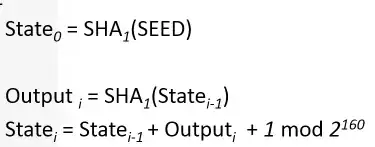

  2. CSPRNG made out of a secure hash function with a counter (Java SecureRandom's SHA1PRNG) such as

The first random stream is just a block cipher in counter mode. If you think back to the security proofs of things like counter mode vs iterated encryption like CBC you'll remember the bounds were better on counter mode. More intuitively, a CBC-like operation could result in a short cycle, such as where $E(E(a)) == a$ - this could never happen when encrypting unique counter values.
The same concept of a short cycle can appear in the second construct as well, but I can't immediately see how adding one does anything besides change the case in which this would occur. Consider $H(S_i + H(S_i))$, if $H(S_i) = 0$ then we have a tight loop. With $H(S_i + H(S_i) + 1)$ we'd need $H(S_i) = -1 = 2^{160}-1$ to get the same loop. For what it's worth, I have not seen this particular construct before which is why I hinted for you to cite it.
