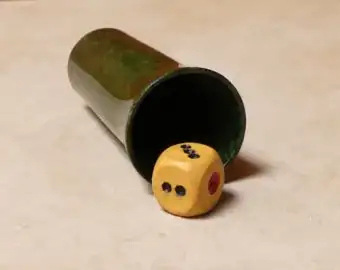

die
when coupled with a simple von Neuman[+] extraction technique?
This is not a facile question. I'm interested in any tangible substantive difference between the two sequences of random bits other than speed. Are they just as random if not as fast? And therefore are quantum RNGs further examples of electronic snake oil?

[+] This experiment produces independent and identically distributed random bits (not 1 - 6) due to the shaker cup eliminating correlations between throws, and the von Neumann extractor removing die bias. 1 truly random bit is generated every two throws (slightly less on average).
